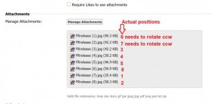

These pictures start with my finished version of what one might see as they walk by. Study the first one pretty good before moving on to the second, third and fourth ones where I show the unpainted version then close-ups of the first two.
The next few pictures show how I made use of that pre-drilled hole in the internal release lever using an electrical connector to secure the cable and the routing of it all.
