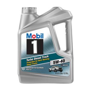

Mobil One 5W-40 Heavy Duty Diesel Oil, available at Walmart by the gallon. It is sometimes in a separate area from the regular oils.
I went a whopping 130,000 miles with it in my Volvo bigrig truck, whilst normal oil change interval was 20,000 miles. I accomplished this thru oil analysis, and changing the three (3) oil filters every 30,000 miles.
https://www.walmart.com/ip/Mobil-1-5W-40-Turbo-Diesel-Truck-Motor-Oil-1-gal/17128879

Nothing. It is probably equally as good. I will use it. It is a little cheaper, and more readily available at Walmart.
I will take it to 10,000 miles, as synthetic oil can be used for at least twice the miles as dino oil.
3
This oil meets the Ryker specs.
I’m not doubting but would like to know why this diesel oil is good to use in our Rykers? Thanks, cueman
Its long been the case that heavy duty diesel oils are both rated for and hold up well in gasoline engines. Just not vise versa. They do especially well in engines that have a shared gear box because of the high shear strength and low wear properties of the diesel oils. Most strictly gasoline engine oils are more concerned with emissions and protection of a catalytic converter than engine wear. MANY motorcycle shops stock and use the Rotella T6. It does carry the JASO MA2 wet clutch motorcycle oil rating as well. Shell maintains that certification because of the large motorcycle customer base for the oil.

Diesel oils typically start out with a higher TBN (Total Base Number) than gasoline oils. The TBN is what fights acidity. Normally, they say oil should be changed when said number is 1/2 the original. If the oil used by Can-AM has a TBN is 9.0 (I'm just speculating), then at 4.5 it should be changed. But if you start with an oil with a TBN of 12.0, then you have that much more life & protection with it.
