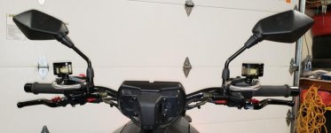

Well here's an update on my Rally, we changed out the cheaper looking handbrake reservoirs to a nicer set, that were more symmetrical and allowed me to use the mirror mount holes on the hand brake. So I removed the endbar stock mirrors for a different style of the brake handle mounted mirrors, and added a new set of end bar weights. Now I have the look I wanted on my Rally, more of a bike look.:thumbup: We also swapped out rear fender to the stock 900 fender, to me it looks cleaner, but that's just my opinion. I am working on a driver's backrest (once completed I'll post pic of it), and I am looking into a windshield that is functional and not just mounted there doing nothing (any suggestions would be appreciated).:riding: I also posted pics of parts installed, so now total cost of mod is about $250 total.
