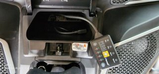

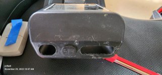

That is the method that Martin the Vlogger used. I ran mine the typical way, and used an old phone holder to screw the pedal box mount to. I can move it over to the glove box in the event of rain. I installed it Saturday and have to say, I am impressed.I have a 2022 RTL. I put my Pedal Commander in the dash glove box. The pictures show the insert pulled out. I used a drill bit and a Dremel tool to cut a slot big enough for the Pedal Commander to slip through without the mounting bracket attached. If I want to change settings, which I won't do very often, I can open the glove box or use the app on my phone. BTW, my phone is almost always on my handle bar mount.
