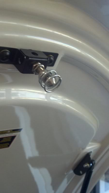

I've seen these springs added to frunklids on RS/GS models... This is now being done on RTs too?

It's a number 155 and the only place I found it easily was at an ACE Hardware. I have a GS; so, I'm not sure what works on an RT.

FRUNK SPRING
Easiest MOD to do...any auto parts store...get a 1/2 in.x 2in. spring...get a 1 in. piece of clear tubing...slide tubing on first....slide spring over tubing....tubing holds spring in place...your done....Mike...:).....:clap:.....:thumbup:......................................this only works on the rs / gs frunk
I did this mod to my GS because the frunk didn't 'pop' open when turning the key, but now that I have an RT-S, the frunk pops open without the need for a spring. Are others not this fortunate? Is my frunk an anomaly?
There's no pin on the RT.
