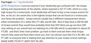

The guy who made the videos claims he heard the noise and saw the fender vibrating at least a day before he found the nut loose and continued to ride it without thoroughly checking into it.
I do think Can Am should have furnished a tool to fit this nut, I will be getting a socket to fit.
If it was rattling and vibrating it would have been loose enough to turn by hand or shake back and forth, so a little basic diagnostic time would have prevented further damage to the wheel and pins.

He has it backwards and so do you. The wheel came loose and that is what worked the rotor pins loose from the wallowing of the wheel on the hub. The pins DO NOT hold the wheel on, they only lock the brake rotor to the wheel for brake force. This really seems to be a simple matter of wheels not being properly affixed to the bike (torqued properly) before he rode it. There is not a design problem or they would all be affected. There are a great many with far more than 800 miles on them. I am sorry for his problems but they are with his dealer for not properly assembling the bike prior to delivery. They now need to fix the carnage and get him back on his bike.

In reality, I do not think there is a problem here beyond bad assembly at the dealership. We've had 1 issue like this and the only information we have about it is a likely misdiagnosis by an owner. I don't mean to demean the guy. And I am not saying he doesn't have a serious problem. But he is more mad than meticulous and gives out some obviously bad information in the video I saw.

I fear that we are making a mountain out of a mole hill here folks. To me it is a dealer mistake combined with a rider who was not paying attention when things started to go south. I don't think his wheel actually came off (for a number of reasons). And I am not convinced that it would come completely off anyway.
What we have here is a great deal of speculation based (frankly) on statements made by someone who doesn't know what he's talking about. I don't mean to be harsh. The poor guy has gotten a raw deal, no doubt. But it isn't anything more than that. If you're worried about getting a raw deal from your dealer, that's one thing. But to say the Ryker has a major safety issue based on this guys problem is a mistake.

Just for grins, I checked my existing 1/2" drive torque wrench. It has settings up to 250 ft-lbs. I don't think that is out of the ordinary. I certainly wouldn't expect any decent dealer shop to need a different torque wrench just for Ryker hubs.

Can-Am did nothing wrong. They created a fantastic machine that uses centerlock hubs like a Formula 1 car. Just because this guys idiot dealer cant grasp the concept of 225ft/lb of torque on a lug nut, and this guy (being a dealer himself) refuses to blame his dealer, he is creating a nonsense conspiracy.
