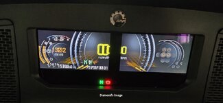

20260424_173137.jpg lol
For those much more wise and knowledgeable than I, I am Looking for some insight and guidance. This is on my 2020 Can-Am Spyder RT Limited with 8,714.7 miles on it. I turned the key on and this is how the display came up. I had to turn the key off, remove it, and wait for the bike to completely reset twice before it cleared. I was able to fully start it and to take it for about a 45 min run with no issues. For the record, this is not camera blur, but it kinda concerns me. Any help would be greatly appreciated.
For those much more wise and knowledgeable than I. Looking for some insight and guidance. This is on my 2020 Can-Am Spyder RT Limited with 8,714.7 miles on it. I turned the key on and this is how the display came up. I had to turn the key off, remove it, and wait for the bike to completely reset twice before it cleared. I was able to fully start it and to take it for about a 45 min run with no issues. For the record, this is not camera blur, but it kinda concerns me. Any help would be greatly appreciated.
If it happens again I would disconnect the battery and short the leads together for 10 or 20 seconds or leave it disconnect for a half hour and hook the battery back up and see it that straightens out the issue.
Remember, if you decide to disconnect the battery cables, be certain to disconnect the Negative cable first and then the Positive cable. When reconnecting the cables, ALWAYS connect the Positive cable first and then connect the Negative cable.
