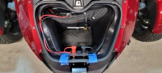

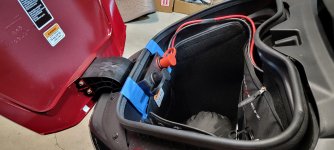

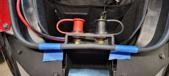

Dry fitting this Amazon jump port and checking cable routing. Frunk closes OK, cables will be secured with zip ties and bases, does not obstruct the opening much at all, everything is right there when you might need it, and the caps secure pretty tight.

That looks super convenient, hope it doesn't get in your way too much. I use the frunk to store my helmet and I'm sure I'd hit or drag across those lugs allot.
That does look like a nice clean job, but how often do you expect to need a jump? In the event I would need one, I keep a small toolkit in the rear cargo that includes a multi-tip screwdriver that could open the battery compartment, and I can't imaging stopping somewhere where I can't flag someone with cables or a jump block. For long trips I carry my own jump block. Or am I missing some other use?
I think I jumped the gun on this one, going to return, just too big and I already have a jump pack and proper wrench if/when needed. Oh well...
I've got a jump cable from NOCO and an adapter to connect to my tender (NOCO as well) that stays behind the carpet…
With what you've got, I wouldn’t be able to store my helmet there!
No harm, no foul. A quality OEM battery should last 5 to 7 years. I got 6 out of mine when it showed its first sign of weakness. I also have the Harbor Freight jump pack that fits perfectly in the bottom of my trunk. I take it out, test it, and charge it once a year. I also have AAA Premium, which covers motorcycle jump start and a 100-mile tow if necessary. Good luck.
