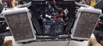

After witnessing this mess when I had my frunk off I decided to install black fiberglass insect screen over the stock grilles on my 2015. I was afraid they might fill up with bugs and crap really fast, but they don't. I vacuum them out every 2 or 3 rides even though it's not necessary. Works better than I had hoped for.
