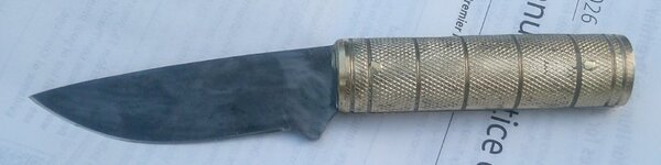

Whats new? Just finished putting the custom made bronze handle on my blade blank. Little bit heavy, but feels like a roll of dimes in your hand and the blade is razor sharp. Still needs more cleaning up and some polishing. No belt case yet, but that will also be custom made.​

An old foot peg?
Not a foot peg. I machined it from a piece of bronze rod. It may have been about 7/8 diameter to start with. Chucked it up with a support about 4 inches from the free end and center bored the free end to take a tail stock live center. Took out the center support and put the tail stock on. Turned about 5 inches of the bronze rod down to just slightly more than the diameter needed to cover the blade tang. Ran knurling wheels over the turned down part of the rod maybe 6 or 7 passes until it had a fairly deep knurl pattern. Switched to carbide tool and put some rings around the knurled part trying to miss being aligned with the 1/8 pin holes in the blade handle tang. Then moved the tail stock back out and put the center support back in. Cleaned up the end with center drilling and cut the knurled handle off with a parting tool.
I split the knurled handle down the center and milled each side to match the width of the blade handle tang. Got a good fit and went over all the fitting areas with a small side grinder very lightly, just enough to rough it up for the epoxy to grip. Drilled the handle pieces to match the pin holes in the handle tang. Cleaned it all up with alcohol and used clear Dupont 2000 pound waterproof epoxy to put it all back with the pins installed and left it clamped in a vise between some pieces of board for 2 days to let the epoxy cure. After that I just bradded the pin ends and cleaned up the epoxy that got on the wrong places.
It looks a little like a foot peg from the side, but it two split halves fastened on the sides of a full handle tang. It is much smaller than foot peg size. It is not round, but more flattened arcs to match the handle tang. Blade was already roughed out and tempered. Now it all just needs some more cleaning up and some final polishing. I have cleaned up the cutting end of the blade and put the final bevels on the edges. A few passes on a table top small belt sander and a little work with ceramic rod, and now it will shave. It is still fairly heavy, but not near as heavy as a foot peg. It is closer to the size of a slightly flatted out roll of nickles. It is not a large knife. Slightly less than 8 inches total length.
