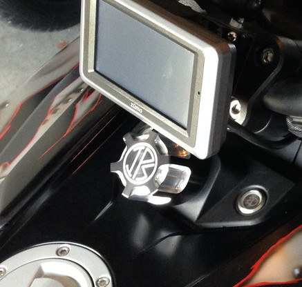

Does it allow one to push the key in and turn to open the seat and frunk?
From a review:
IPS ignition key cover​
Posted by Tanya MacBean on Nov 16th 2022
The IPS ignition key cover is a very esthetic addition to my F3S. It looks like it should be stock, but better! Easy to install Esthetically pleasing Ease of operation, for ignition, frunk opening & stock fuel door opening.
I highly recommend!
