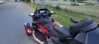

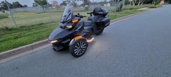

Instead of posting a bunch of messages over many weeks, I decided to just complete as many of my changes and post them together.
From first to latest:
- Revivify Self Healing Nano Coating applied immediately upon delivery. https://revivifycoatings.com/
- Carbon fiber applique from Wrap My Spyder to hide the piano black
- BRP Driver floorboard lights.
- Awesome Flasher and shifter buttons mod from our friends FrogmanDave and TCBoone.
- Show Chrome Fender and mirror flasher mods with custom made plug & play harness.

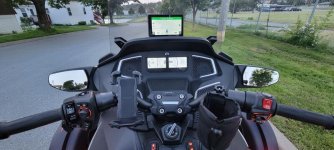

- Zumo XT with BRP mount on centre of handlebar. Didn’t’ like having to look down at GPS, relocated GPS on upper dash. Much better position and no sky reflection on the display.
- BayaRon Ultra bar and Spring adjusters. Best Mod so far! Excellent handling improvement.
- BRP Passenger armrests. Happy wife, happy life.

How did you mount your RT up there?
Hi Ollicat,
I assume that you meant XT in your question.
I used almost everything in the Zumo XT box except for a 1 inch Ram ball with a circular base that was purchased from Amazon for $10.
The Ram base is held in place by 2 small strips of 3M double sided moulding tape.
Running the Garmin power cable to the small slit on the dash is a bit of a PITA. Because of the obstructions under the dash, routing the Power Adapter cable needs to be done in two steps.
Step 1 - Remove the right side Tupperware

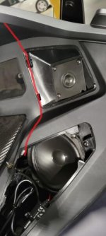

Remove the right side Tupperware, remove the upper and lower right speaker covers; and remove the upper right speaker.
Step 2 - Drop fishing line/cable
To fish the Garmin Power adapter I used a 2 foot length piece of scrap 3 wire electrical cable. I inserted the fishing cable into the right dash slit towards the upper right speaker. With the upper right speaker removed, I was able to grab the fishing cable and pull out a 6 – 8 inch length.
Then route the 6-8 inch length from the upper speaker, down to the left side of the lower right speaker.
Step 3 - Secure and Retrieve Power Adapter

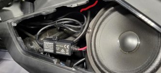

At the lower speaker, using electrical tape, secure the fish cable to the Power adapter cable. Carefully pull the fishing cable back up to the top right speaker first.
Then carefully pull the fishing cable from the dash slit until the Power Adapter is at the slit.
Step 4 - Expand the slit and pull Power Adapter out
The Garmin Power Adapter is a bit bigger than the slit opening. I used a small round piece of wood that I inserted in the slit to expand the slit enough to pull the power adapter through the slit.
Step 5+ Wrap-up
The worst part is over. Now just attach the power adapter to the motorcycle mount as per the Zumo XT user manual page 6.
Connect the Garmin power cable to the BRP GPS adapter.
Secure any loose wires.
The finished product
If you run into issues, feel free to contact me.
Good luck

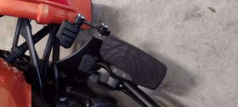

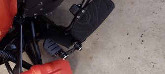

I wanted more ways to place my feet on my F3-L so I installed new brackets and Kuryakyn foot pegs that I bought from Lamonster. These worked great and now I have many comfortable options. One thing though. When I installed them as they're designed to be, I felt like I was doing the splits, so I turned the pegs inward. I was afraid that on the right side that this may interfere with the brake pedal, but it does not the way I have it adjusted.

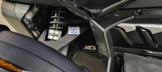

After having some awesome people on this forum send me instructions for mounting air scoops on my 2012 RTS, I spent six hours in the garage trying to get it installed.
The part I did not look forward to was cutting the panels, but it was not as difficult as I feared.
I also took the opportunity to replace the rear brake pads while it was up on the lift. So now I will ride the rest of the season instead of tinkering in the garage!:ohyea:
